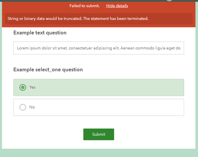

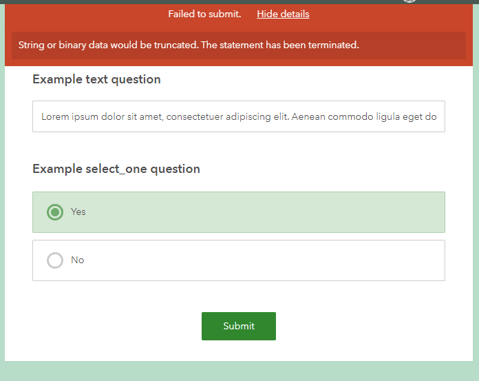

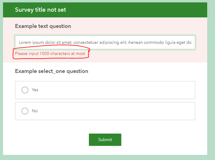

I have problem with new version of survey123 connect 3.16 and text question.
I published text question and set bind::esri:fieldLength to 1000 but user can write over 1000 without getting error/hint like old version of survey123 connect 3.15 which give you error.
I put screen shot of two versions below:
new version
old version
as you can see we don't get error massage anymore. I know I can write constraint but why this bug happening.

Hello @anonymous55
This issue was introduced with our 3.16 December update, we are aware of the issue and are looking to have a fix applied as soon as possible.
Thank you,
Zach
