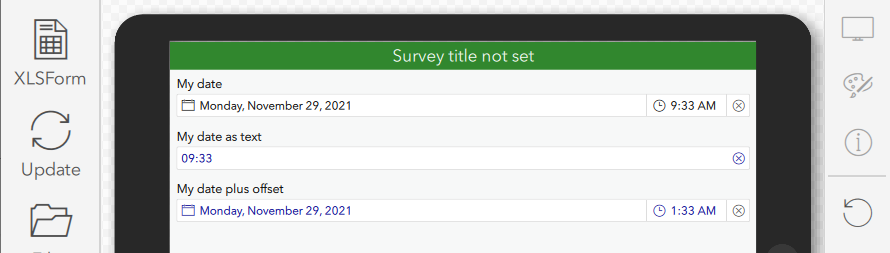

I know this one has been covered a lot and Ive been trying to get a calculation from a previous answer to work but so far it just gives me an empty field.
now()+pulldata("@property", "utcoffset")*1000*60*60
I'm trying to create a hidden field from Survey 123 Connect that when I open the Feature Layer in Pro will have the converted DateTime field showing my local time etc when the survey result was captured.
So far it just turns up blank o matter what I try??

Hi. Try the following:
  • Option 1: Create a text question and use the calculation to store a string using format-date
  • Option 2: Create a datetime question and apply your expression to the calculation
If you want to hide your calculated value, apply the hidden appearance to your question. Do not use the hidden question type, use the hidden appearance instead.

I followed the steps you provided above and it all looks good in the survey but once the survey is submitted and I access the Feature Layer either in AGOL or in ArcPro the "My date plus offset" field is empty. Thanks
