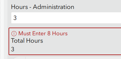

I have a survey that is trying to track work hours done on a variety of tasks. Each different task is set on a repeat. Each worker must account for 8 hours in a day.
Is it possible to sum the value of the entries and constrain it so that the sum of the entries must be over 8?
This is how I have it set up now:
typenamelabelcalculationconstraintconstraint message
calculatetotal_hoursTotal Hours${hours_admin}+...{hours_yardwaste}${total_hours}>=8Must Enter 8 Hours
What am I missing? I have attached my xlsx.

I changed the field to a note and it all worked.  It will not fire on constraint on the field that is just a calculate since it does not show on the screen.
As you see above though I do not think this is what you want as this requires each task to be 8.  You need a total outside the repeat and a constraint on that. And you need to bind to decimal otherwise 123 thinks its a string.  (or use decimal then hidden appearance) See attached.
But in the end why are you making one hours field for each type?  This form could be way, way simpler just having a hours field.  See second attached.  You repeat table will show which task it was.  Going forward your original schema is going to be a nightmare to use.  Basically you have to check all those fields all the time.  Just use one hours field is the better schema way to do it.
Hope that helps
