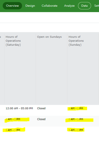

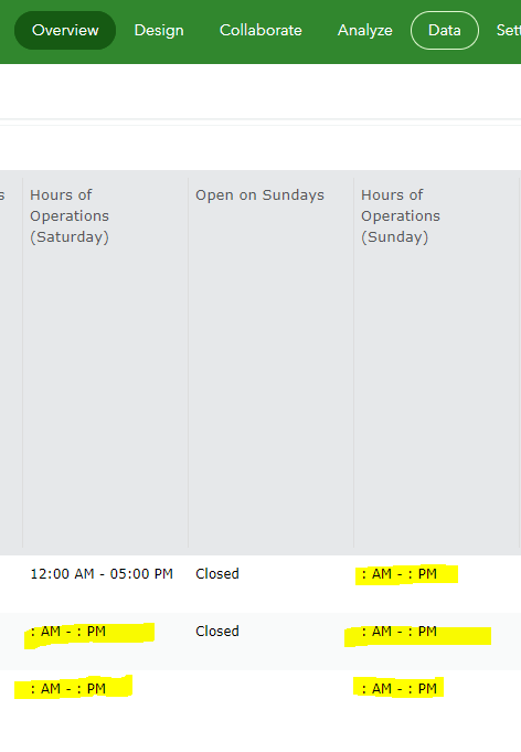

Hi, I just upgraded to version 3.17 and I'm noticing that inputMasks are entering values matching the mask even when a user does not enter values in the question. This wasn't happening in version 3.16, arg.
For example, I have an inputMask set to 99:99 \AM - 99:99 PM so users can enter hours of operation - 08:00 AM - 08:00 PM. Well now if users enter nothing, I get  :  AM -  :  PM.
Additionally, I have a default value 'Closed' if user answered previous question as 'Closed.' I am using body::esri:visible in hours of operation to hide the question and not clear out default.
Is there a way to fix this so that the attribute is just left blank or it respects default value?

Hey thanks for the suggestion, but haven't been able to resolve just yet. The 3.17 field app still submits empty input mask values so for now I think I'll remove input masks.
