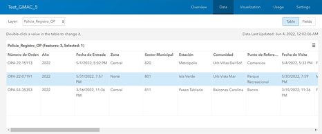

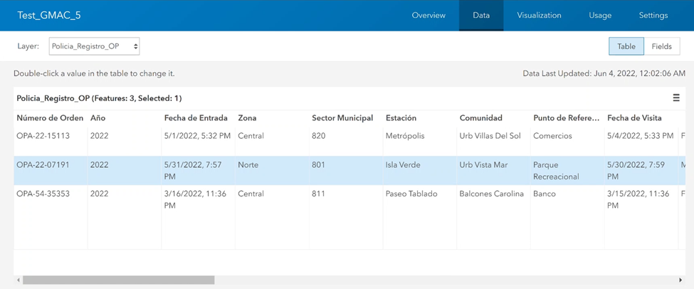

As expected, the Zona field determines the list that appears under Sector Municipal. However, after a Sector Municipal is chosen, no data is shown for the Estación field. The following image shows sample data where, indeed, there is data under the Estación field.

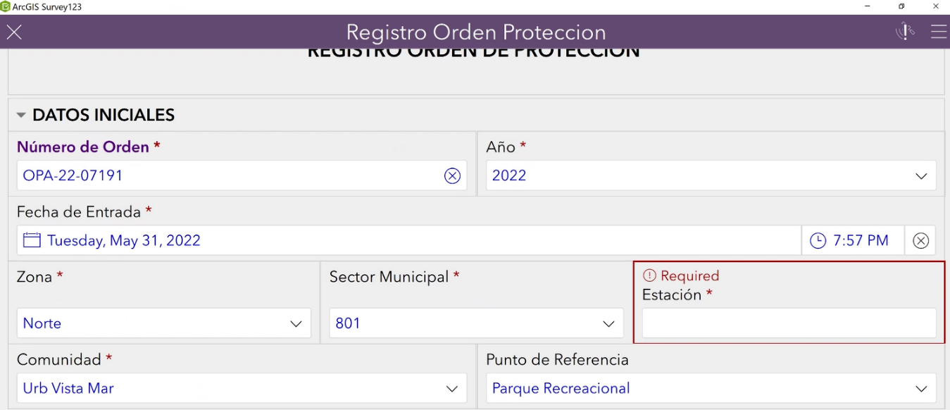

However, when we look at the survey for the Número de Orden entry ending in 07191, we see the Estación field is not behaving as expected.
We have seen that when changing the Sector Municipal to another choice on the list, and then back to the original choice (back to 801 in this case), then the Estación field behaves as expected and shows the correct choice.

You are not alone - I have the exact same problem - I created a sample survey with just two questions and a choice filter on the second.  The second question is saved correctly.
When a survey response is loaded from the inbox, the response on the filtered question is empty, and you have to select another option in the previous question, select the original, and reselect the option in the filtered question.
In the much more complex survey where I have this problem, you can actually see the choice being loaded where it appears in red, then disappearing. Questions that are readonly are not affected and retain their values.
The basic survey is pretty much the same as your example;
typenamelabelchoice_filter
select_one cantonadmin1Select a Canton
select_one villagevillageSelect a villageadmin1=${admin1}
I'm using Survey123 Connect 3.15.165, and the field app 3.15.145, with ArcGIS Enterprise 10.9.1.
This worked before so I think was possibly introduced at v 3.15
I have logged a case with ESRI support who have logged BUG-000150592.  For now the workaround is to either to disable the choice filter when the survey is being edited, or remove the minimal appearance from the question;
if(pulldata("@property", 'mode')='new',admin1=${admin1},true())
 This doesn't delete the responses any more, however the user then sees the entire choice list.
