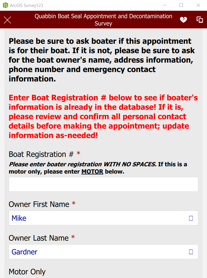

My "key" field is a registration number; when that is entered, a person's information is pulled from the CSV into my survey form. Previously when I was testing this in August, the form would be blank until I entered a value and hit "Enter" - then the personal information would appear.
Now, when the survey form is opened and before the registration is entered, a value from the CSV is auto-populating all fields where pulldata() is in use.

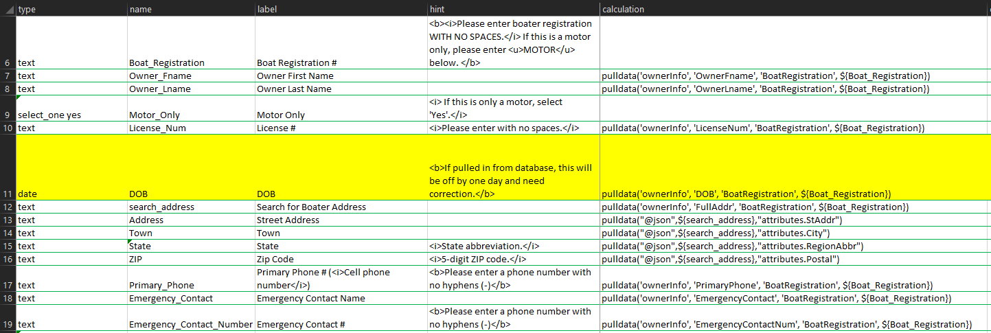

Here are some examples of my pulldata() functions.
Example of what I see when I open a brand new form; notice no registration has been entered, yet information is showing up from the linked CSV:

Check your csv file data. I've had a similar problem and found that a null value in a column for the lookup was recognized as a value to pull data. My csv had a blank space with subsequent data to be pulled and was automatically the first to be retrieved upon opening the survey for that reason. Hopefully, it is something that simple for you.

So simple! I checked my CSV for special characters, but did not notice the 2 records that were blank in my lookup column. Thank you so much!
