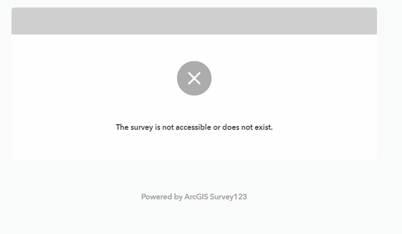

However, when I sign into the site, it comes up with the following message:
I've been able to download Survey 123 Connect, connect to my Portal, and publish forms/feature layers there, but can't seem to access the website.
I've tried troubleshooting by following the steps in this document: Error: The survey does not exist or is not accessible (esri.com)
I've removed all he duplicate HTTP response headers from Portal and Server web adaptors but still coming up with the error.
Has anyone encountered this issue?
