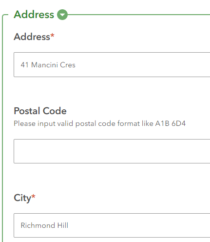

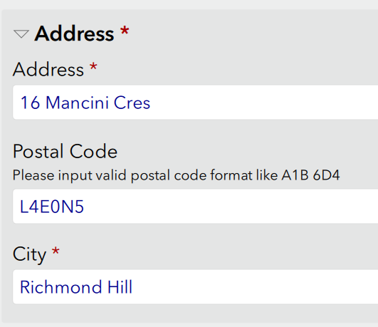

It works in Survey 123 connect:
But it doesn't works in web browser.
If I only have postal code, it works but only show the first 3 characters.
Any clue? Thanks!
