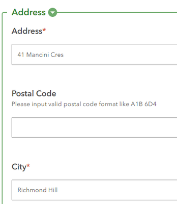

Hi,
Canadian postal code format is A1B 2C3. As survey 123 geocoding reverse result, we only got the first 3 characters as "reversegeocode.address.Postal". While we get the last 3 characters from "reversegeocode.address.PostalExt".
So I merged these two into one as:
pulldata("@geopoint",${location},"reversegeocode.address.Postal") + pulldata("@geopoint",${location},"reversegeocode.address.PostalExt")
It works in Survey 123 connect:
But it doesn't works in web browser.
If I only have postal code, it works but only show the first 3 characters.
Any clue? Thanks!
Fan

Hi Fan,
Try to create two null questions and each of them calculate first 3 code and the rest of 3 code. Then use 'concat' to put them together as calculate in postal code question.
E.g.Name, Calculate, Esri field type
postal_123, pulldata("@geopoint",${location},"reversegeocode.address.Postal"), null
postal_456,pulldata("@geopoint",${location},"reversegeocode.address.PostalExt"), null
postal_code, concat(${postal_123}, ' ', ${postal_456}).

fyang
Thanks Kerry!
But we are using a standard data model (shared with other applications) so cannot create extra field for that. I know extra fields calculation is a work around method. But I'm seeking a direct solution base on existing field calculation.
Thanks for your advise!

fyang
Thanks Kerry!
That works!
