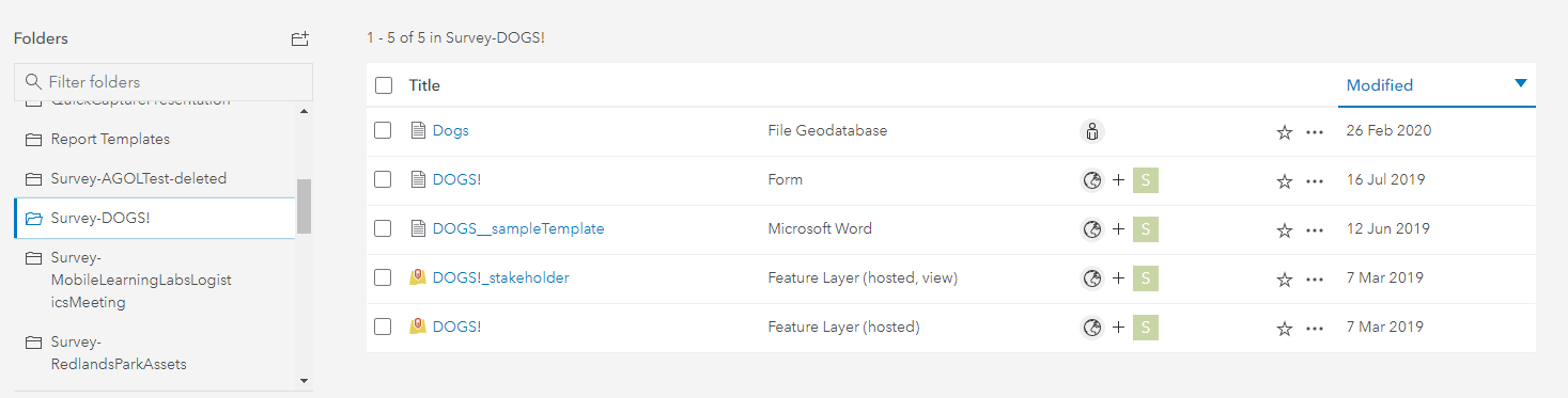

When it publishes a folder is created in your content that contains the Form Item, Feature Service (and views as necessary), and maybe a Web Map if you published from Survey123 Connect.
As long as the settings on the Hosted Feature Service are set to "Allow others to export to different formats", you can export the data as a File Geodatabase. You can then connect to the File Geodatabase and see how ArcGIS Survey123 built the Schema, and you can model your schema that way.
