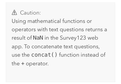

Jelle_Stu_PR
I also came across this issue once. if I remember correctly it had - in my case - to do with concatenating two string. In excel the string is concatenated correctly using ‘+’, while online this had to be done using the concat() function. See this warning in the documentation of survey123:
gyetman
I only use the + to add numeric values in the sheet. I wonder if one of them is being interpreted as text when it should be a number, I'll check!
