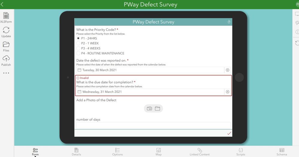

In Survey 123, I am trying to create a survey answer based on the results of previous answers. For example in the image above, a users chooses the priority level and then the day the defect was reported on. The Due Date for completion has to to be limited to 24HRS/1 Week etc from the defect date based on the responses given. I have tried constraints and calculations on Survey 123 connect, but connect get a solution.

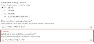

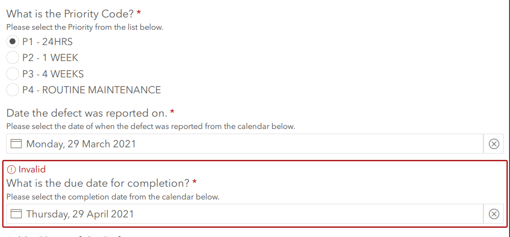

I tried updating the XLS form, but it doesn't seem to be accepting the constraints. In the form attached, I have limited the date to one day from today but when I add the due date, it doesn't accept it as valid. Not sure if I am doing this correctly. Any ideas?
UriGilad_EsriAu
Hi @PatrickMcGarry1,
Just had to shuffle a few lines - see attached xlsf with corrected fields. Note that currently 'P4 Routine Maintenance' = 100 days. Change it in the calculation field to fit the number of days you're after.
