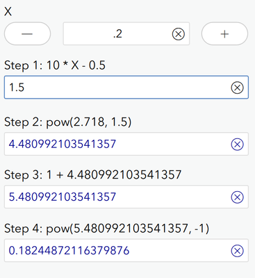

I broke it out step by step, and it appears that it's the "1 / " that is the problem. Instead, try using this:
pow((1+pow((2.718,(10*(${InletPerchLow}-0.5))))), -1)
It's mathematically equivalent, but Survey123 seems to not have a problem with doing it this way.
