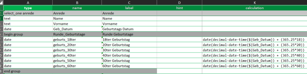

I used the following formula (from here Decimal date time—ArcGIS Survey123 | Documentation😞
  • 18th Anniversary: date(decimal-date-time(${Geb_Datum}) + (365.25*18))
  • 20th Anniversary: date(decimal-date-time(${Geb_Datum}) + (365.25*20))

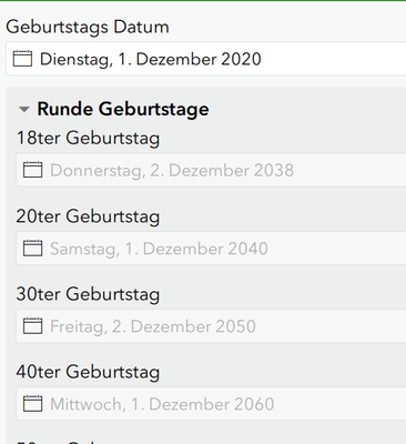

But when I enter a Birthday, the calculation seems to have a 1-Day error, but only in some Jubilees.
Birthday date 01.12.2020

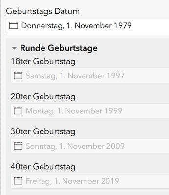

Very strange is that depending on the date entered, the same calculation seems to be right:
Birthday date 01.11.1979

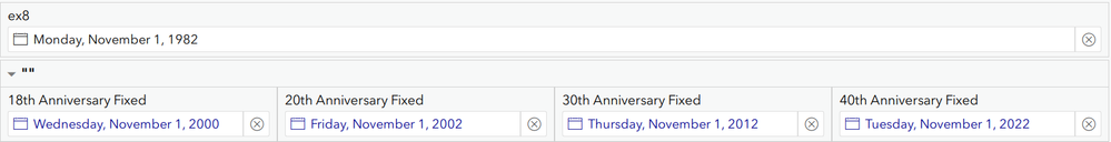

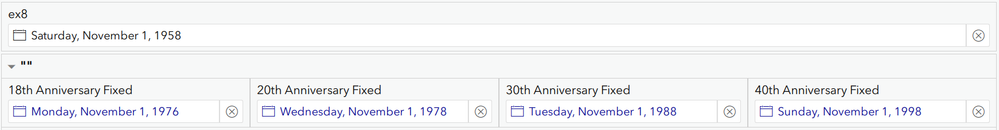

AlfredBaldenweck_0-1671810321270.pngAlfredBaldenweck_1-1671810461640.pngAlfredBaldenweck_2-1671810517174.pngAlfredBaldenweck_4-1671810603730.png
I think your solution should work! It's certainly a lot less confusing than mine.

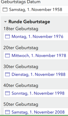

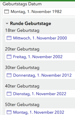

I thank You so much for all the effort and time you took to help me out....but unfortunally the last formula also didnßt wor for me.

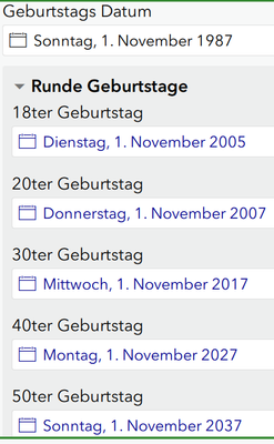

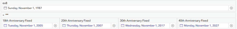

The same formula worked good for the birthday date 01/11/1982, 1987 and 1958:

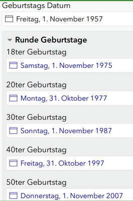

But for the birthday date 01/11/1957 it had a day difference in the 20th and 40th anniversary:
I think a difference like this, using both of us the same formula, might have to do with the settings of windows, the date and the separtion...comma or point or something like this...I cannot figure out why we get such different results... It is very stressing... 😪

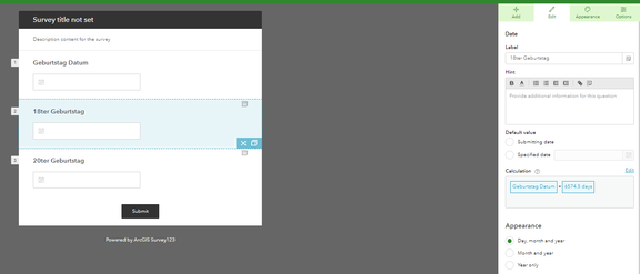

thanks for your concern. Actually i thought it could be a great idea to try theSurvey123 Web Design to try and solve it that way, but unfrotunally it also didn´t work.
I created a birthday date field, and the 18th and the 20th birthday date field, just to try out.
The only way to calculate a date in the future, is to add a certain amount of day. So for the 18th birthday I multiplied 365.25 days18 times (6574.25), and for the 20th birthday I used 7305 days (365.25*12):
 On Preview mode you can see I made some attempts on selecting 11th of November 1979, and unfortunally the problem of 1day difference still persist:
It is really unbelivable...I am still wondering if it is me who is doing something wrong...🙄
