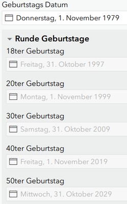

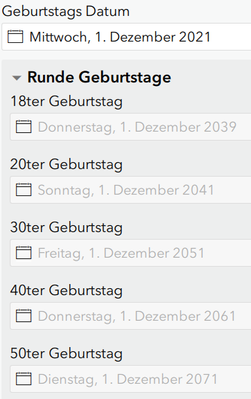

But when I enter a Birthday, the calculation seems to have a 1-Day error, but only in some Jubilees.
Birthday date 01.12.2020
Very strange is that depending on the date entered, the same calculation seems to be right:
Birthday date 01.11.1979
PLEASE HELP!!😕

thank You for your suggestion, I tried it and guess what? the results were inverted. The Birthday date 01.12.2020 previosuly wrong, was now right. And the birthday date 01.11.1979 previously right is now wrong.
Any other ideas?
Thank You very much!!

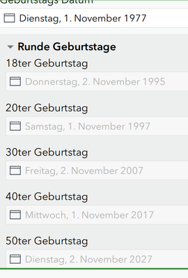

I took another look, and it looks like it's specifically having issues with the year AFTER a leap year, as well.
Luckily, that's an easy fix.
if(format-date(${Ex8},'%Y') mod 4 = 0 or format-date(${Ex8},'%Y') mod 4 = 1 , date(decimal-date-time(${Ex8}) + ((365.25*18)- 1)), date(decimal-date-time(${Ex8}) + ((365.25*18))))
This formula checks to see if it's a leap year or the year after by seeing if it is evenly divisible by 4, or if it has a remainder of 1. (I checked each year from 1977 to 2010, so it should be good)
1977-1981 for proof:
AlfredBaldenweck_0-1671727812160.pngAlfredBaldenweck_1-1671727840035.pngAlfredBaldenweck_2-1671727860287.pngAlfredBaldenweck_3-1671727882424.pngAlfredBaldenweck_4-1671727911312.png

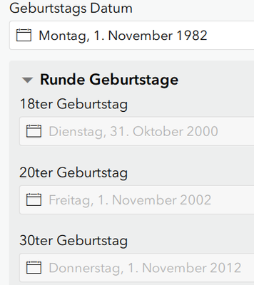

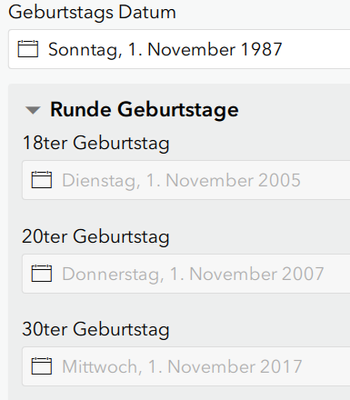

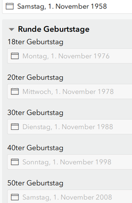

Hi Alfred,
I tried it out but please take a look at the Birthday date 1st of November for the 18th Anniversary with the formula:
if(format-date(${Geb_Datum},'%Y') mod 4 = 0 or format-date(${Geb_Datum},'%Y') mod 4 = 1, date(decimal-date-time(${Geb_Datum}) + ((365.25*18)- 1)), date(decimal-date-time(${Geb_Datum}) + ((365.25*18))))
This formula worked good for years: 1987, 1988,1989, 1990, 1991 till 2022 showing the 1st of November,
but for the years 1986, 1985, 1984, 1983, 1982, 1981 is showing 31st of October
It seems unfortunally there are no leap years involved in this logic...
Leap years were: 1980 1984 1988 1992 1996
Then it get´s more interesting because for year 1980 going back to 1958 it is showing again the correct 1st of November BUT from year 1957 backwards is showing again the wrong date of 31st of October and also the 50th anniversary show a different date..
I am getting so upset! I can´t seem to find a logic...   😥
