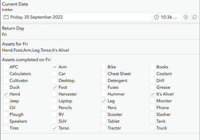

LaurenceTait
If I'm understanding you correctly:
You have a list of tasks.
Each day is associated with a pre-determined list of tasks that is a subset of the full list.
You want your operators to select the day, and then you want the survey to generate the list of tasks for that day so they know what they are expected to do.
And you also want that list of the day's tasks to appear as the default answer for a select_multiple question, so your users can add or subtract tasks from that list depending on whether they complete more or less tasks than expected.
So your final result should look something like this:
Is that correct?
If so this can be relatively easily achieved using paired CSVs and the 'pulldata' and 'select_multiple_from_file' options.
