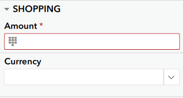

I am working on a survey wherein the form will automatically tick a value in the select multiple question if he/she has an answer in a certain question.

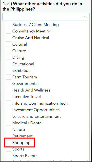

For specifics, if the user has an input in the Shopping Amount, that will automatically select Shopping as other activity in a select_multiple question.
Client also wants that the Shopping Amount be required if user has selected Shopping in either one of the two questions above - that one I figured that out, but the other requirement is still unsolved.

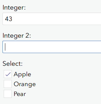

The problem is that your select_multiple isn't read only. As soon as a user makes a selection, the calculates will either stop working, or override the user selection (depends on you calculateMode). Neither of these scenarios are good though.
But, to do what you want:

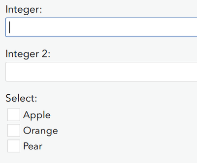

But, as I mention above, here is the issue. As soon as the user makes a selection, you get a "refresh" icon:
This indicates that the calculates are no longer going to work... or, you can set calculationMode=always and the user's selection will be over-ridden.
The only real way to do this is to have the select_multiple be Read Only.

Hi, abureaux! The select_multiple question cannot be a set to read only because the users need to select all other activities done in the area.

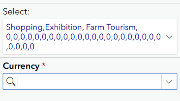

I am trying to formulate a workaround for this process by using concatenate to get the values from the select_multiple above to add with the Shopping concat only, but those that are not selected are returning a value of 0. Do you know how to remove the other zeroes?
abureaux
MVP Frequent Contributor
I'm not sure where those '0' would be coming from off-hand. I'd have to see the XLSX.
