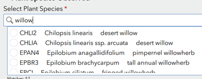

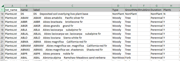

In my CSV I have the code as the name and in the label I have Code   Scientific Name   Common Name (4 spaces in-between each).  This way a crew can search on anything they know and find the right plant.  Code, Scientific, Common are all interchangeable.  Each user knows plants differently so this is great.
Also what is cool if they say know its a willow they can just type willow and it shows them the options for that state.

I appreciate you so much you are extremely quick with the help and are all over this board. I have one more question. I have it autopoluating the names perfectly. The next question after refers to status. on the csv file i have the status of the plant in the 3rd column next to the names. how do i make my status question autopopulate based on the name typed in the previous answer. please see below for example of csv file.
AbildgaardiaovataAbildgaardia ovataFW
