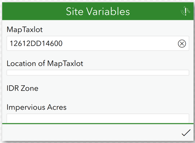

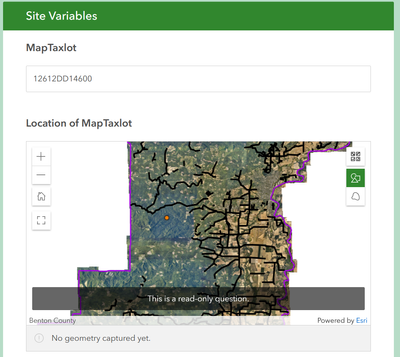

D_AnneHammond
So now I have a different issue, this code
pulldata("@layer","getValueAt","geometry","https://gis.co.benton.or.us/arcgis/rest/services/Public/TaxlotService/FeatureServer/189", concat("MapTaxlot=' ",${MapTaxlot}," ' "))
is not returning the taxlot geometry and the survey still expects a point location input.
Seems like this is a simple enough concept but clearly I'm not catching on... and Survey123 connect won't show a map at all which is not helpful, I have to open the survey a web browser to see the map
Jim-Moore
Hi @D_AnneHammond
The pulldata("@layer") expression shown above should use the getValue operation, as opposed to getValueAt. The distinction is that getValueAt requires a geopoint so that it can query the feature layer "at" a particular location; whereas getValue uses a WHERE clause to filter the features by attribute (in this case, filter on MapTaxlot and return its polygon).
Could you please try changing to getValue and see if that helps?
Jim
