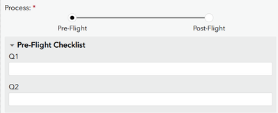

Thirdly, I will suggest this method. It's similar to what you were originally looking for, and has the added advantage of allowing for some user error:
The user is presented with the Pre-Flight checklist upon opening the form:

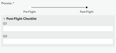

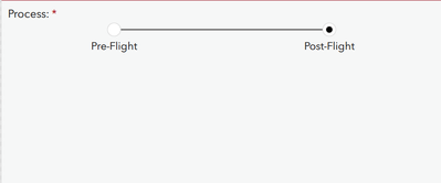

And selecting Post-Flight does nothing:
After they fill in whatever field(s) you make your "indicator" field on the Pre-Flight side, they will be able to select Post-Flight:
