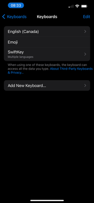

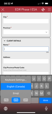

I cannot see SwiftKey in the iOS app, just the iOS Keyboard and Emoji Keyboard. I could have sworn that was an option in the past. Am I missing something here?

Using 3.19.114 on iOS 17.1.1 I'm seeing the SwiftKey keyboard working in the app. The only place I see it not work is when authenticating with my ArcGIS organization. Is that what you are seeing as well?

Using iOS 17.0.3 and Field app 3.19.114. I am currently updating to iOS 17.1.1 to see if that fixes it.
I am able to use SwiftKey in texting applications, just not in S123. I see this:

Nope, iOS 17.1.1 does not restore SwiftKey.
