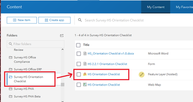

1. Navigate to the Feature Layer in question:
2. Export a FGDB of the layer
