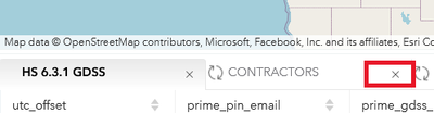

Essentially, the more repeats, the longer it can take to load. You may have just hit a point where the number of records + the survey complexity is resulting in a slower browser experience. When I run into that, I have found that removing all of the related records and saving a bookmark of that "custom view" is super beneficial.
While in the web-browser, click the x for all of the related records:
You will notice the URL changes to be something like https://survey123.arcgis.com/surveys/xxxxxxxxxxxxxxx/data?hideTables=1,2,3,4,5
