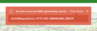

miharobarinho
Hi,
for past 14 days, we are unable to create reports from our templates. The error occurred every time, with no difference creating pdf or doc dokument. also saving to esri account or locally brings no difference. I am sending you a snip of an error. Before past 14 days it worked ok. We are just implementing survey 123 and that is a big issue for us.
We have several projects, and non report generation works, amount of data is low, and also no images are present, just a map of location. Also just one record can not be exported.
I am still unable to see and understand, what solution did some of the customers used?
Thanks, Miha
miharobarinho
And a snip of an error:

miharobarinho
Hi,
I have tried some more tests on our Survey 123 report generating error. We are unable even to download sample template, getting the same error code: 504, as you can see in attachment. In the past month, there were no changes in the environment of the Enterprise portal. Also services for Survey 123 projects were not built on top of existing services, but are brand new for each survey 123 project - we are in test mode.
Thanks in advance for any new suggestions, what could it be.
ZhifangWang
@miharobarinho ,
Thanks for attaching the screenshot.
If the 504 error also occurs when you try to download a sample template, it indicates that the Survey123 website cannot download/access an item from your org.
Can you please share some more details?
  • Are you connecting to an ArcGIS Enterprise instance on the Survey123 website https://survey123.arcgis.com?portalUrl=  ?
    • If yes, can you please confirm if your ArcGIS Enterprise can be accessed from the internet?
  • After deleting all existing report templates, can you create the 3 sample templates successfully?
  • In addition to the 504 error when downloading a template, can you upload any local report template successfully?
