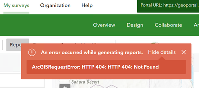

None of the reports can be generated because of ArcGISRequestError: HTTP 504: UNKNOWN_ERROR for all of my surveys.

for us in Slovenia is the problem still there. No changes, still getting same error. Firewall is set correctly, we are trying to diagnose what causes this error with our local ESRI distributor and your support team.

I am having a similar issue, we have been generating reports for over a year from the same survey and suddenly it just refuses to create a report. Strangely i can create reports for other surveys but not the one i use most. If i save the template to my hard drive as a word doc and then load it back in then i get get an error warning
Error: binde type esriFieldTypeString for question telephone_number is not constist with feature layer field type esriFieldTypeDouble
I understand the issue here but is it possible to change the field type if i created the app in the web designer?

our IT team did some change in azure proxy, then onwards this issue coming, any advises ?

Have you confirmed you can still reach your REST services from outside your domain after the proxy changes?
Aneel_Kumar_M
Now it is working within our network, all working, except reporting. we can submit forms from our mobile devices with VPN. records are storing in our SQL, data is viewable. only reporting is the issue, dont know what went wrong.
earlier, when they configure azure proxy with pass-through, all working, but they decided not to make it pass-through due to some cyber security controls.
