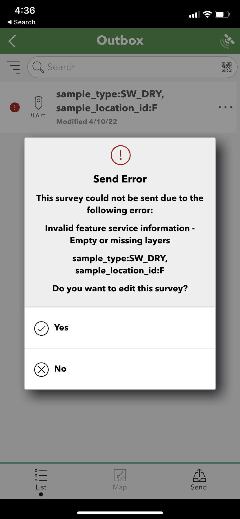

On the Survey123 mobile app I am getting the error below when submitting a survey. This survey was created in Survey123 Connect based on a feature layer.

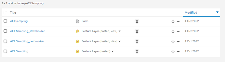

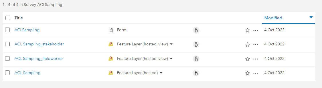

The AGOL folder contents for this survey and feature layer and views looks like this:

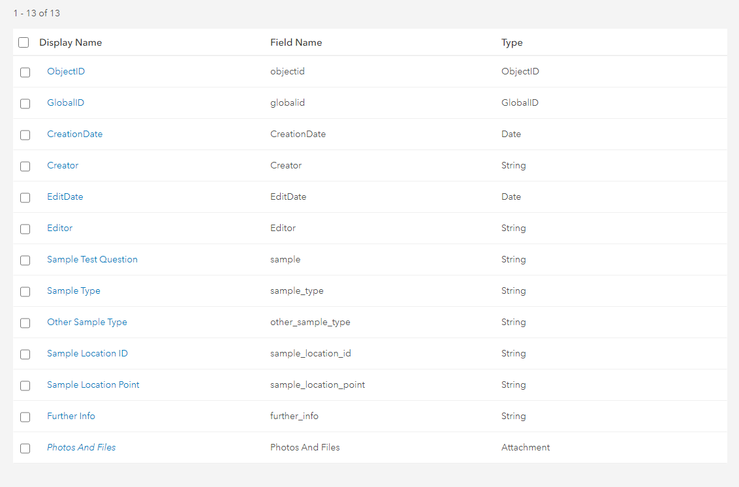

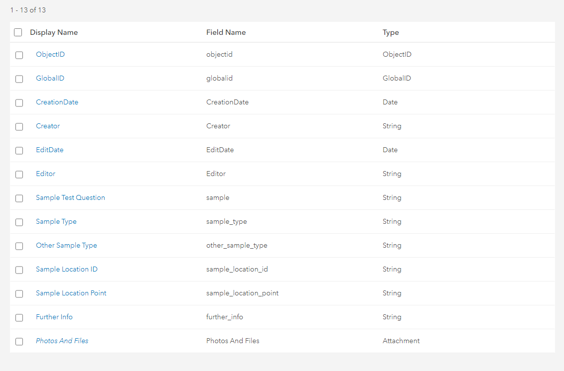

And the fields in the feature layer look like this:

@Hayley I believe the issue is related to the feature class you are publishing to. I cannot recreate the issue when pointing to a new hosted layer created by the survey.
Inspect your layer to try and identify what it is causing the layer. If you get the same issue submitting via the web app you can use network traffic to potentially lead you to the cause. Failing that work with your Tech support Team
Hope this helps
Hayley
Hi @Richard_Purkis, thanks for that I'll have a deeper dig. Will changing the feature class name in AGOL break any links between the survey and layer?

I have the same problem.
The survey works fine when I use the browser, but it fails when I am using tje Survey123 app
Hayley
Hi @SørenAndersen1
For some reason it didn't work for me on Apple, but then I tried submitting on an Android phone it did work. Do you have the option/capability to do this?
