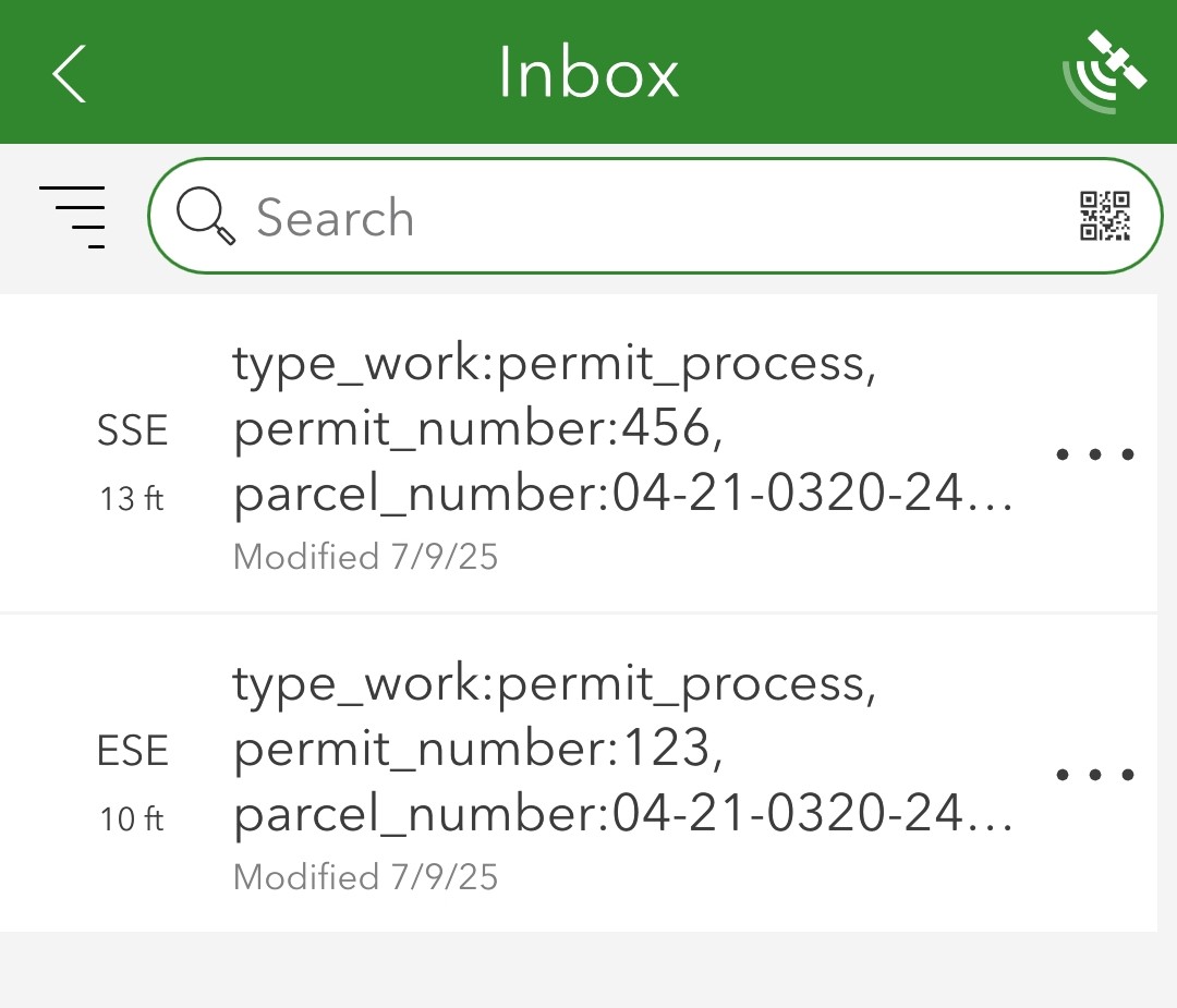

1) When I see the list of records in the Inbox, they show the field names instead of the field labels (screenshot below). Is there any way to fix this?

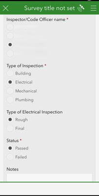

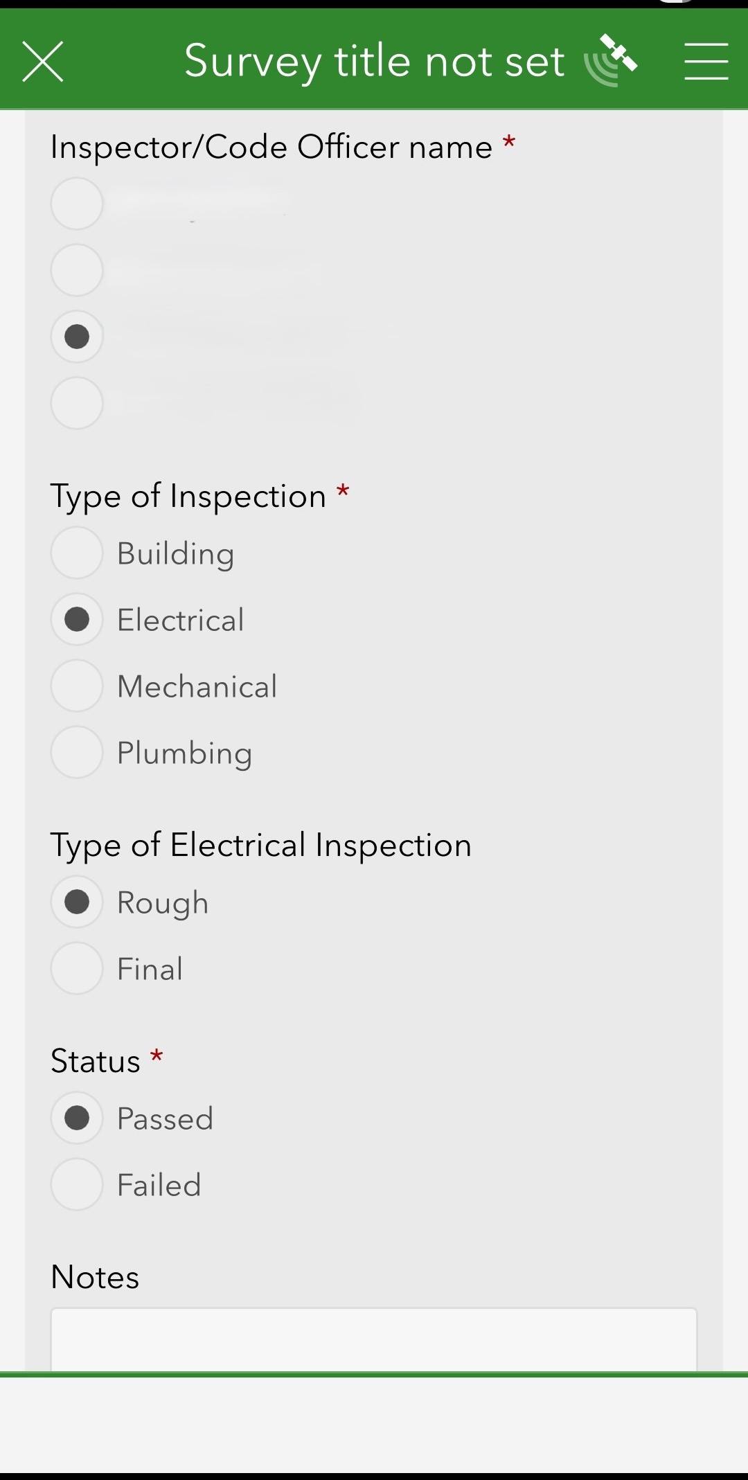

2) When I open the record, it shows the options that were not chosen (screenshot below). Is there any way to only show the options that were?

Neal_t_k
You can try jr:choice-name(), not sure if it will work for this, but it supplies labels instead of names in other instances.
https://community.esri.com/t5/arcgis-survey123-blog/survey123-tricks-of-the-trade-xlsform-functions/...
4 Replies
dsinha
I figured out part of the solution for (1) by selecting the fields that would be displayed (see instructions here), but it is still showing field names instead of labels.
Neal_t_k
abureaux
MVP Frequent Contributor
looks like you got this one mostly sorted out. You will need to use jr:choice-name() as @Neal_t_k suggested to get this working the way you want.
Short answer is "no".
Longer answer is "yes". You can get the desired result by:
  1. Detecting if the form is, for example, not "new" by using pulldata("@property","mode")
    Use this in the survey:
    This is the result:
  2. Dynamically hide the select_one/select_multiple fields using the body::esri:visible column with something like ${header_mode}='new'
  3. Dynamically show a note or a readonly text field. Just do the reverse of step 2.
  4. For the content of the new text field, you will need to use jr:choice-name() as @Neal_t_k suggested.
Generally speaking, those are the steps.
Personally, I wouldn't do this as showing all the options is typically good practice. But my field is pretty technical and litigation is always on peoples minds. Depending on your use-case, this may be acceptable.

The jr:choice-name() solution worked as described. For the second issue, I just changed the appearance to minimal.
