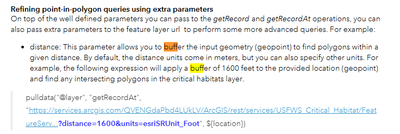

The layer you are trying to pulldata from is a point layer, so unless they click the exact right spot you are not going to get a response,  I am not sure if this will even work for a point layer.  You mentioned making a polygon layer from the point layer, have you tried referencing that layer instead of the point layer?
Another option would be to configure the query to search within a distance of your location.
https://community.esri.com/t5/arcgis-survey123-blog/survey123-tricks-of-the-trade-pulldata-quot-laye...
Again not sure how this will work with a point layer.
Neal_t_k
MVP Regular Contributor
This works, but it is a very big search radius, and I don't know which point it is returning, the closest, or more likely the first in the list. You could play with this shrinking the search radius until you are happy.
pulldata("@layer", "getValueAt", "attributes.mw_manh_24", "https://maranaegov.com/server/rest/services/Hosted/MW_MANHOLES_2025/FeatureServer/0?distance=1600&units=esriSRUnit_Foot", ${location})

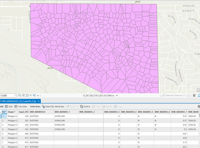

You need something like this for your pulldata to reference
In ArcPro:
Create a border for your area of interest.
From your point layer, use the Create Thiessen Polygon tool (output fields - All) to make polygons
Clip the Thiessen Polygons to your border layer.
Publish the resulting feature layer and use that feature for the pulldata query.

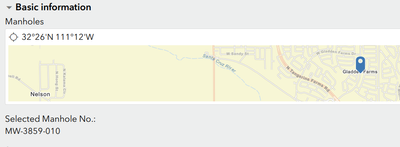

Teresa-AZ
Hi Neal - I created a 10-meter circle for them to Click and I have to be careful since I do not want it to overlap on other manhole covers.  I will add in the distance code, as you did, to hopefully be able to get it to work.
Hi abureaux - I was able to do that and it was successful, however I wish for them to only use the S123 app and therein lies my problem.
I will attempt what Neal suggested since that "seems" like it would work for us and I see his image with it working.
I will let everyone know what happens here. THANKS!  - T
Teresa-AZ
IT WORKED!  Thanks!
Neal, you are the Best!

Neal_t_k
or, If it were me I would make a polygon layer (similar to a parcel layer) where each polygon has one manhole attributed to it and use that instead of your current point layer for the pulldata query.
Neal_t_k
In ArcPro:

Teresa-AZ
Teresa-AZ
IT WORKED!  Thanks!
