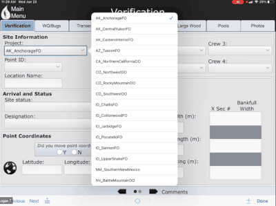

Yes for sure.  In FileMaker it will even auto expand the drop down for you.  So much faster, so many less taps.  I think this is what you want right?

This is another use case for tab order also.  Please update here https://community.esri.com/t5/arcgis-survey123-ideas/add-tab-order-to-survey123/idi-p/941555
I have some other ideas here  https://community.esri.com/t5/arcgis-survey123-questions/specific-ideas-to-speed-up-123-data-entry/t...
About the only feedback we get from the Crews now is how slow data entry is in 123 vs our old programs which is a bummer.
