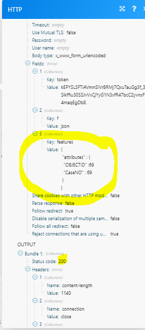

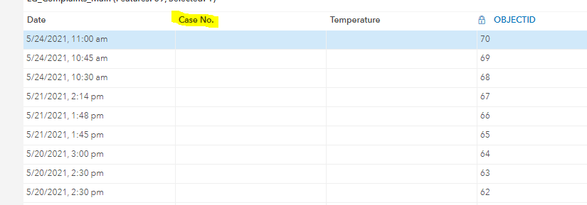

I am trying to figure out why my Integromat webhook works without errors but I cannot see my value updated in the table.
I followed the instructions of Ismael on this post: Survey123 Tricks of the Trade: Integromat - Esri Community
(I also recreated the same scenario as the one with the Temperature field updated from the Weather service, but I got the same "error").
the problem is that I don't get any error. The value just doesn't update.
Is there anyone that is able to see what I am missing?
thanks!!!

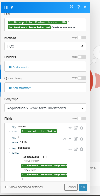

Hi @PanGIS ,
Apologies for the delay in response. please note that the value of the features parameter in update features should be an array (begin/end with []), not an object ({}) - https://developers.arcgis.com/rest/services-reference/enterprise/update-features.htm

Anyway, after your post I tried the following with no luck:
Originally, it was this:
{"attributes" : {
"OBJECTID" :{{1.feature.result.objectId}},
"CaseNO" : {{1.feature.result.objectId}}
I added squared, but it didn't work
{"attributes" : {
then I tried,
"attributes" : {
also
"attributes" : {
"CaseNO" : {{1.feature.result.objectId}},
"Name": "Jeen Doe"
and
{"attributes" : {
"Name": "Jeen Doe"
I have no idea.
