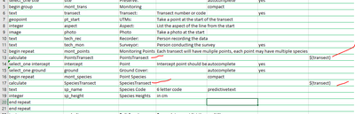

You mention using S123 for a 50m transect, collecting point intercept data (e.g., ground cover, % cover and height). I am trying to create a field form for vegetation transects but I am having difficulties with the repeat questions data- my species data is in a separate table than my point data. Is there a way to link the two repeat questions for more efficient data analysis? As it is, I can assign the transect ID to mont_point and mont_species by the timestamp but can't necessarily attribute mont_species to a particular mont_point.

DougBrowning
MVP Esteemed Contributor
Not sure I understand but maybe.
If you want the 2 repeat tables to know what transect you are on just add fields and push it in there.
I do this all the time.  I tend to use it to push in my main key that I use later in a relationship.
Hope that is what you wanted.  Is this a pin drop method?  If so we do that using Top, Lower1, 2, etc instead of a repeat.
