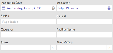

I discovered a workaround by accident and have started using this method in all my surveys.  I thought I would share this in case anyone else would like to use it.  I set my surveys to pages only, being my surveys consist of several pages.  Then I assign an appearance of w2, w3, etc... to groups I want to have more than one column.  No borders are seen anywhere unless I want one.  Then I just set borderColor="black" or whatever.
I would like to add that fields within these groups with more than one column will always be w1.  For example, if you set a group to w2 and want the question to use up the entire w2 width, it will not.  It will remain w1.  So one will need to be creative when working this way.
Here is an example of one of my groups set to w2.  Notice no borders.

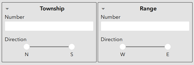

This is an example of a group set to w2 with nested groups with borders.
