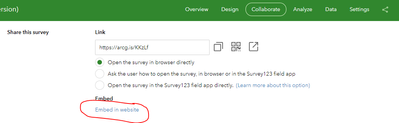

If anyone is watching this for a solution, ESRI provided a workflow which allows surveys to be embedded within an iframe but inherit the language of the page it is being embedded within. This is achieved by sharing a different link to your survey with the website creators to that which you could find here:
Instead, you should click the Collaborate tab in the options shown above, and click the 'Embed in website' option highlighted below:
This will give you a popup to the right of the screen containing HTML that can be copy and pasted into the website and it also contains options for embedding, to remove survey headers from the HTML if you need to. This option will only be available to you if you have shared the survey publicly as far as I know.
