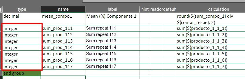

FedericoRiet_Sapriza
Hi @DougBrowning
thanks for you response.
I try this, but still have issues with the formatting and the sum of the repeats.
When I choose "hidden" or "calculate" in the type column the calculation do not work.
I can't upload my XLSForm here for some reason.
Cheers,
Federico
DougBrowning
What type is producto_1_1_1?   I think seeing the form would help but I do not see an attachment option in the editor either.
There must be a way to attach right?  Weird  Maybe the 123 team knows how.
