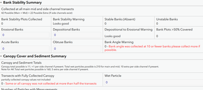

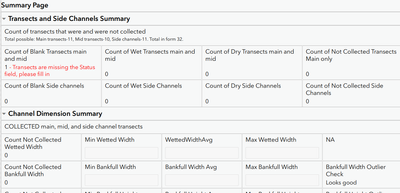

DougBrowning
I do this with summary pages.  That way I can actually point out errors in red vs just having them look at it.  I also show min, max, avg, etc to help the crew see any funky numbers that are prob typos.
In some forms I also use emojis.
Just thought I would post in case it helps.
Your idea is tough cause then there would have to be some UI to config what the "report" would look like.  That is a pretty big change to the app.
