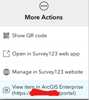

  4. Open the survey item in your portal

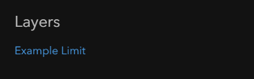

  5. Under Layers, go to the feature service created by the surveyAlfredBaldenweck_1-1729014567107.png

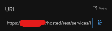

  6. Scroll down to "URL", copy it, and add "/0" to it.
    https://yourURLhere/hosted/rest/services/Hosted/serviceIDhere/FeatureServer/0
  7. Back in Survey123 Connect, copy that URL into the calculation for the recordcount question, replacing the dummy one I put up there.

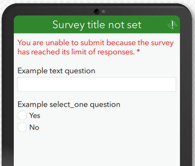

  10. Start collecting. After the number of records has been surpassed, that note will pop up with the warning and the required message, not letting you submit any more records.*
    1. I could only get this to work after reopening the app, unfortunately.
Tried to video it but ran into trouble editing it. This is how it should look
