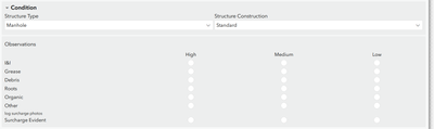

It would be helpful to provide a method to apply the theme-grid to individual groups as opposed to the entire survey.  I have very long, complex surveys where it would be beneficial to consolidate questions/answers in which the choices are the same.  In the screenshots attached, I have groups using theme-grid and would like to use table-list outside of those groups. Thanks.

@JamesTedrick This has been partially implemented. True you can now apply some groups as grids without having the whole survey style set to theme-grid/ dynamic-grid/ fixed-grid. However we seem to lose the ability to change specific fields widths within the group.
dynamic-grid applied to group & table-list:
dynamic-grid applied to setting (with desired field widths) & table-list that doesn't work within the dyanmic-grid setting:
