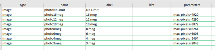

Check out the newish max pixels
https://community.esri.com/t5/arcgis-survey123-blog/survey123-tricks-of-the-trade-photos/ba-p/897907
Looks like
I did testing and really anything over 8 MP we could not really tell the diff.
Also make sure on iPad to get the photos to most compatible in settings or you lose all the Exif.
Hope that helps

IsmaelChivite
The max-pixels parameter should do the trick.
If authoring the survey from the web designer, we added one option to limit the size of photos and files.
Both of these options should work from both the web and mobile/desktop apps. Otherwise, a software defect should be logged.
