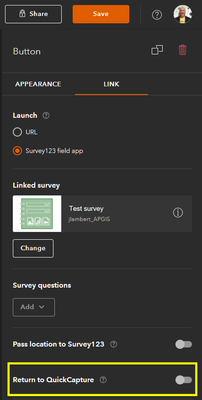

Not sure if you are trying to pass data or not, but assuming the tracking feature and survey feature are separate; I would suggest starting in QuickCapture to begin tracking, launching Survey123 from a link button in your QuickCapture project with the setting to return to QuickCapture upon submission enabled (see screen capture), then stop tracking in QuickCapture.
