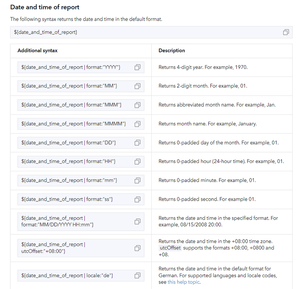

For #2: Regardless of the format used to capture the date/time, you can control the format used to outptut a Date/Time value in a PDF report.  For example:
If you want to add AM/PM, use A (or a if you want it as am/pm).

For #2....I posted this idea quite a while ago and I have learned so much since then, including being able to better format data outputs in a custom report template. But thank you so much for clarifying about the "A". It might be helpful to include that particular syntax in the quick reference guide (as you show in your screenshot) as well?
