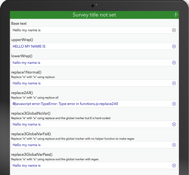

To be fair, I had not tried JavaScript for this.
So, with a little help from w3schools and Stack Overflow, I gave it a shot.
Here are the functions I used:
 * JavaScript functions for Survey123
function upperWrap(arg1) {
    return arg1.toUpperCase();
function lowerWrap(arg1) {
    return arg1.toLowerCase();
function replace1Normal(arg1, arg2, arg3) {
    arg1 = arg1.replace(arg2, arg3);
    return arg1;
function replace2All(arg1, arg2, arg3) {
    arg1 = arg1.replaceAll(arg2, arg3);
    return arg1;
function replace3GlobalNoVar(arg1, arg2, arg3) {
    arg1 = arg1.replace(/e/g, arg3);
    return arg1;
function replace3GlobalVarFail(arg1, arg2, arg3) {
    arg1 = arg1.replace(/arg2/g, arg3);
    return arg1;
function replace3GlobalVarPass(arg1, arg2, arg3) {
    var regex = new RegExp(arg2, "g");
    arg1 = arg1.replace(regex, arg3);
    return arg1;
To summarize: replaceAll() does not work, so you have to construct a Regex object if you want to be able to replace all instances of a substring in a string. Ok, cool, learning moment.
So, to your point, yes, you can for sure use JavaScript to get the text functions. Takes some trial and error, but it is possible.
That being said, it feels pretty silly to have to use JavaScript just to capitalize my input, since all I did was create a wrapper function to use a normal string method. Kind of like breaking out a carpet cleaner for a bathmat. Yeah, it works, but more of a production than it needs to be. Just look at the calculation field for each of these questions, not even touching the JavaScript.
JavaScriptIdeal setup
pulldata("@javascript", "functions.js", "upperWrap", ${base})upper(${base}
pulldata("@javascript", "functions.js", "lowerWrap", ${base})lower(${base})
pulldata("@javascript", "functions.js", "replace1Normal", ${base}, "e", "a")replace(${base}, "e", "a")
