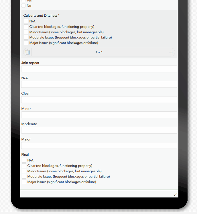

For multiselects, it's a lot more complicated:
NAMECalculation
calcjoin("; ", ${culverts})
finculv0if(not(contains(${calc}, "Clear")) and not(contains(${calc}, "Minor")) and not(contains(${calc}, "Moderate")) and not(contains(${calc}, "Major")) and contains(${calc}, "N/A"), "N/A", "")
finculv1if(contains(${calc}, "Clear"), "Clear,", "")
finculv2if(contains(${calc}, "Minor"), "Minor,", "")
finculv3if(contains(${calc}, "Moderate"), "Moderate,", "")
finculv4if(contains(${calc}, "Major"), "Major,", "")
finculvconcat(${finculv0},${finculv1}, ${finculv2}, ${finculv3}, ${finculv4})
(For the record, all of these except for finculv were calculations bound to Null; they do not actually appear to the user).
It would have been SO MUCH easier to just unique(${culvert}).
