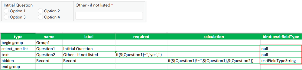

3) In a new survey, I often use Calculations to take user input, and write it out to other hidden fields.
For example, Select_One / Select_Multiple questions where I need an 'other' option. Instead of splitting my question across two attributes for 'or_other' (which creates the attribute 'Specify other.'), I use a second question in the survey form to capture any value not in my choice list, with the requirement that one of these fields must contain a value to be valid. I then us an if statement or concatenate to populate the response that is actually written to the hosted feature.
In the below image, the first two questions are set as null, and the response that is written to the hosted feature is hidden.
The problem I have with this approach is that when you open the record through the Inbox, the questions on the form are empty (as they are set to 'null') - and require values to submit!
So instead of being required to include all these additional attributes in my hosted feature just to use the Inbox, I would like to be able to configure an Inbox view of the form which shows the final result field ('Record' in this example) rather than the initial questions ('Question1' and 'Question2') that aren't actually captured!
