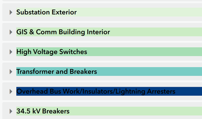

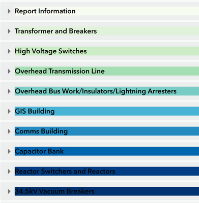

Below, Substation A represents a custom field reordering, given one substation's needs. Substation B shows what the original survey looks like.
Substation ASubstation B
Screen Shot 2022-07-22 at 8.46.30 AM.png Screen Shot 2022-07-22 at 8.54.19 AM.png
In the spirit of consolidating this process (rather than create 30+ unique substation inspection surveys), I'm requesting a solution for reordering of fields in Survey123, conditionally based on user input.
