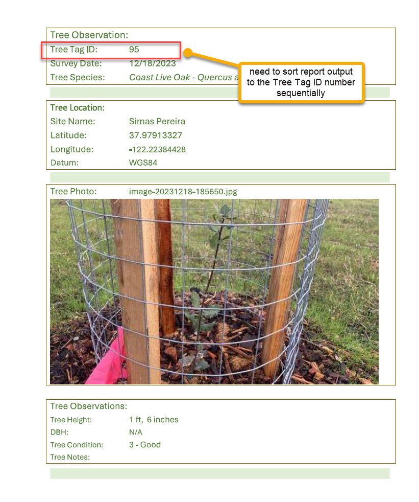

DeborahDennison
I am interested in the ability to Sort collected repeat information based on a field.
Our team used a survey to document the planting (and health)  of hundreds of trees.  We surveyed/documented the work by different team members with S123.  Consequently, and for practical reasons, we have physical tree tags that are number in different groups such as:  300 to 360; 64 to 125; 1-63; 126 to 300, and so forth.  It is not efficient to tell staff to log the trees sequentially.  We have simultaneous Survey users and it is impractical to orchestrate a survey sequentially to accommodate a problem with sorting in S123.
When creating a report, we need the Tree Tag ID number to be sequential:  1, 2, 3
Not 95 to 254, 1 to 94..... , and so forth.  There are over 10 groups of collections.

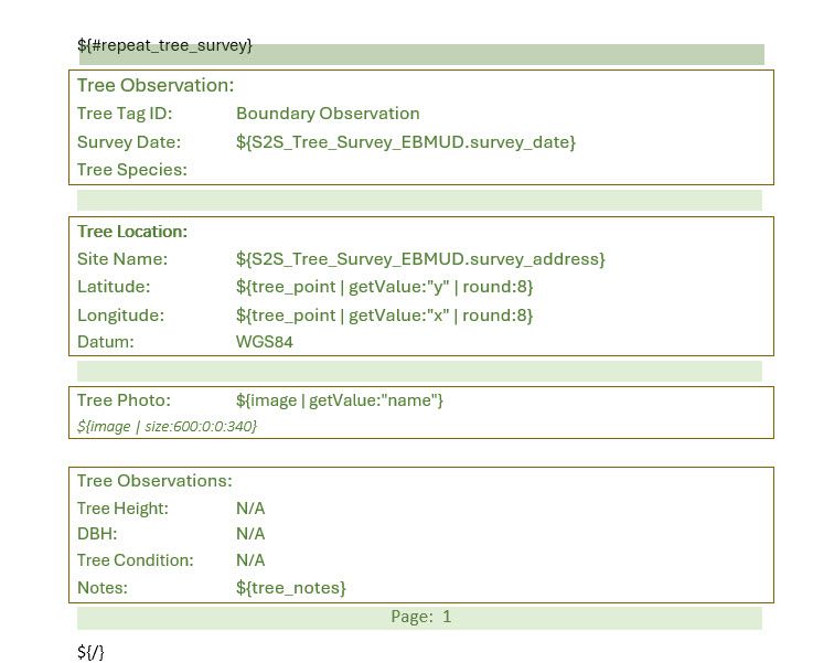

I understand there is an OrderbyField, but from my understanding, a #repeat section cannot be individually displayed in a summary.  Or is the summary capable of this?
Really, it would be ideal to use the OrderbyField in the Repeat section.
If anyone has any tips on how to get around this, that would be so helpful!
Here are images of the Report Template and the Results:
Results from the printed template:
