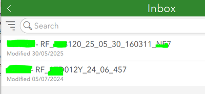

since the idea still needs clarification here my scenario:
I have a survey that creates reports and it generates a ref number
I was asked to change the ref.No schema since the incremental number at the end is not reliable and it creates duplicates.
The report can be updated until is ready for review so, it is still available for editing in the Inbox until then.
below you see the old one and above the new schema
the code is fine when I open it
if I hit the refresh button.
the dateTime is the same as it is set as once() but the schema is different and it will update.
the calculation mode is calculationMode=whenEmpty, but still it updates
my options are:
1. I create a new survey where I allow the edits but I am going to receive complains for the number of survey that need to used (already 5)
2. I beg the inspectors not to touch that button until all the old reports are reviewed (they are more than 800, it will not happen overnight)
Always thanks for your help.
