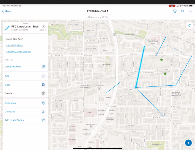

I have been experimenting with this using callback URLs.  In the apps it is working.
Here is a sample where I launch 123 from Field Maps, pass over some data, then when they hit submit it flips the user back to Field Maps.  You can give it a map ID or I think just leave it off and it flips back to the app I think.  Can also pass data back.
arcgis-survey123://?itemID=9269d29cfc994accb9c3739c556ee345&field:LOCAL_ID={LOCAL_ID}&field:GeoGUID={globalid}&callback=https://fieldmaps.arcgis.app?itemID=60898699d9194370985ba5d1b88ac966

DougBrowning
Post the full URL you are using so we can see it.  Did they launch from Field Maps to start with?  That was assumed.
arcgis-survey123://?itemID=956bd35dde0743cf5ddbcd&field:PointID={PointID}&field:EvaluationID={expression/expr0}&field:TransectSpacing={expression/expr3}&callback=https://fieldmaps.arcgis.app
It should just flip back to the app like this - Click in Field Maps to launch 123 then on Submit flip back to Field Maps.  No need for anything else since they just came from Field Maps.
Hope that does it
