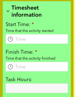

CesarAvila
Hi guys.
I need something similar about this.
Basically into the survey there is a repeat, into it, the user needs to input the time they start and finish Activity A. If the user needs to do more activities, needs to submit start and finish time on every repeat.
Now the user is going back on the repeat to Activity A to figure it out the time he is starting Activity B (means the finish time from Activity A is going to be the start time of Activity B). There is now way to prepoluate that finish time into the start time of the next activity?
I've researched a lot but couldn't find another blog besides this one. Please let me know if it's possible @JJames.
Thanks.
Regards.
NathanMack
@JJames
You can use an indexed-repeat with repeat index2.
typenamelabel calculation
begin repeattimesheetTime Sheet
calculaterepeat_index1 position(..)
timestart_timeStart Time ${prev_time}
calculateprev_time  indexed-repeat(${finish_time}, ${timesheet}, ${repeat_index1}-1)
timefinish_timeFinish Time
end repeat
