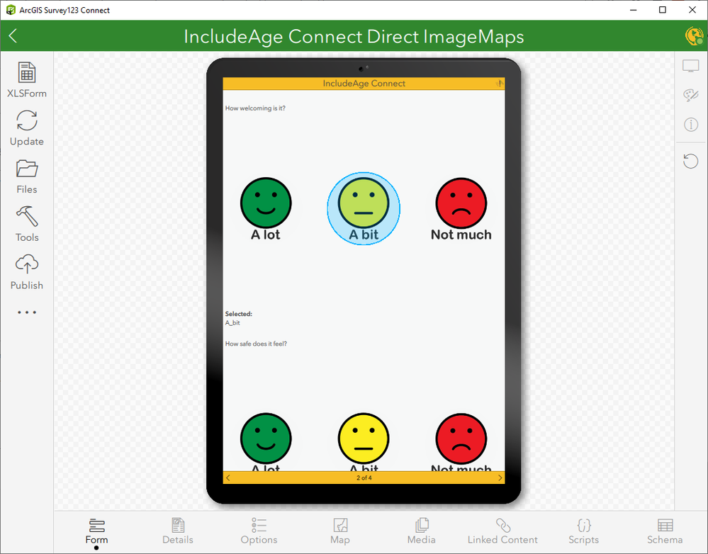

I take it the narrow horizontal imagemap with large spaces above and below on portrait devices has not yet been solved?
I'm developing a survey to be used by folks with learning disabilities and we don't want multiple pages or too much scrolling. Landscape mode is impractical. They will be using tablets provided to them, and may have visual difficulties so just using the add image to choice is not a solution either...example.png

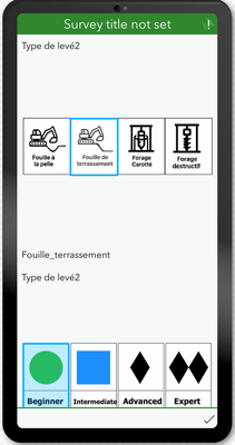

On the phone it becomes even worse...
Image map is a nice feature: having the quickcapture feeling with big explicit button is a understimated feature for user acceptance, especially on the field when your brain don't want to focus on reading small text, and meanwhile processes images automatically.
This display issue is however such a pity, it prevents us to build compact forms, and the benefice listed above is lost with unoptimzed  frustrating space, requiring the user to extra scroll down for no reason.
We only use imagemap on 20% of where we would like to implement it because of that.... Hope the Survey123 team will address that !
Léo
...(why this extra space?)
