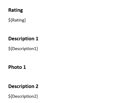

Going back to the Manage Templates link you will be able to download the sample template to your computer.  Once you download the template, you will realize that it is a simple Microsoft Word document. This is what the sample template for my Water Violation v2 survey looks like:
You can see right away how templates work: A series of placeholders for questions in your form are included in the template. The most basic syntax for the placeholders looks like ${question_name}. All you need to do is to make your Microsoft Word template document look the way you want and insert the Survey123 feature report placeholders accordingly.
Once you are happy with your report template, you can upload it using the Manage Templates link.  Until you get familiar with the placeholder syntax, I suggest you start easy: Start by rearranging text within the document and copying and pasting the placeholders from the sample template. Change the color and style of the text, arrange existing placeholders within tables, etc.
Generate a report again with your updated template to see the effect.

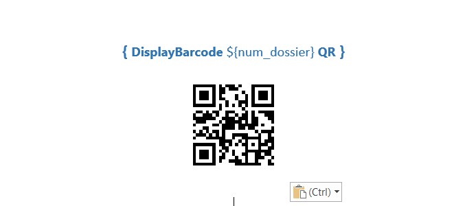

DelaereMickael
Hello everybody,
i am trying  to integrate the  DisplayBarcode formula from microsoft windows in my feature template.
but when i download the feature report the qr code return, the name of my field....
any idea?
My users love cutting trees, that's why they need to print...

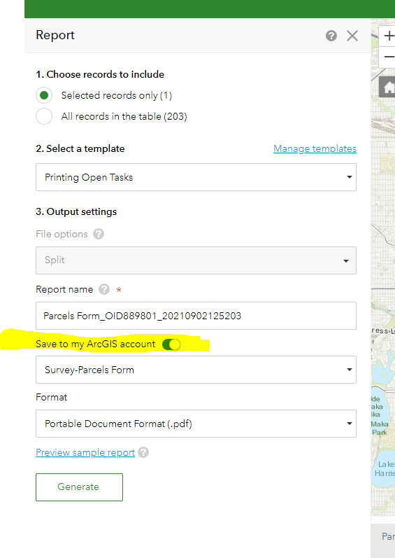

oakmn
Is there a way to have turn "Save to my ArcGIS account" default to off?  Or is it possible to add a parameter in the url to turn it off by default?

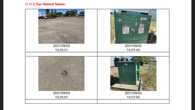

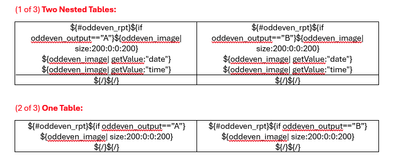

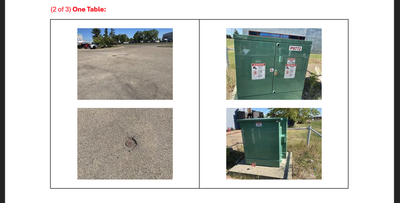

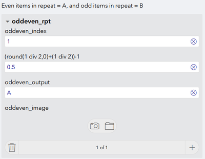

Horizontal photos isn't something the Feature Report service handles "nativity". I am aware of two different ways of achieving that goal. Examples are below. You can play with the formatting quite a bit, but this should at least point you in the right direction.
Option 1: Calculates
XLSX:
Another view:
Feature Report (It's hard to see here, but example #1 is comprised of three tables. The main table, and then two nested tables in Columns A and B):
Results in:

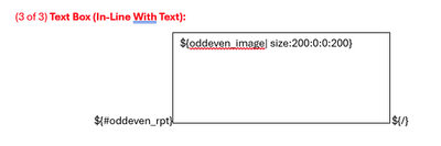

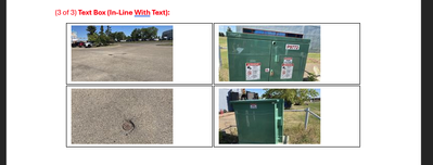

Option 2: Text Boxes
This one just needs some document formatting, so is the least technical approach. However, I also find this to be the least accurate method, so I tend to not do it.
Results In:
